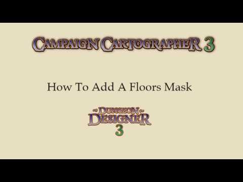

If I'm guessing right, you can add a wall mask after you finish laying out the cave floor. It's wise to add the mask last. I did a video tutorial on wall masks, if it'll help. Sorry for the brevity. I'm using my phone, which is no way to post on a forum.
In some cases you will always have shadows over the walls. In those cases you can create a floor mask.
