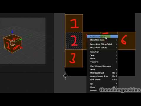

Either manipulate your map to fit the UV in an image editor, or stretch the UV map to take equirectangular maps in a UV editor (UVMapper works nicely, and the basic version is free).
If the image is inverted, you can flip it in your image editor or in the 3D material properyies..
The video on the last link has some very good stuff in it, so you want to watch that one, even if you opt to use another 3D program as he shows you how to put a globe texture onto a UV map in GIMP.
