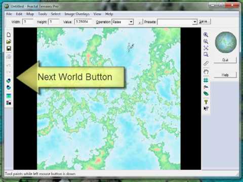

I don't need it to be perfect... that's not really going to be possible. But I'd like to get at least the level of detail demonstrated in this video...
He is exporting to CC3, it looks like. He needs to increase the output resolution in his CC export.
Using File>>Save Campaign Cartographer file, select the desired Export Settings and click Edit. Click Next until the Detail Level page is shown. Move the slider to the right to increase the output detail level. Then keep clicking Next until the wizard closes. Then that export setting file will save a higher-resolution output (unless you're using the FT demo, in which case you'll be limited to the minimum output resolution no matter what you select; only the full demo will create higher-resolution exports).
