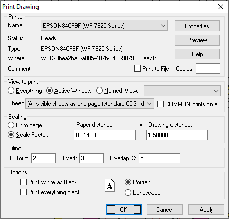

  • pvernonpvernon Betatester 🖼️ 34 images Surveyor
    Hi,
    My take on this is that is too complicated. Below is the print menu.
    OK from the top; 1) select the correct printer. Since you were sending a PDF to the GM select a PDF printer.
    2) "View to Print" - select "everything"
    3) "Sheet" - make sure "Standard CC3+" is selected.
    4) "Scaling" - select "Scale Factor". for "Paper Distance" put in 1", for "Drawing distance" put in 5'. {Mine is in metric.)
    5) "Tiling" - put in the overlap %, 5% seems to work well, YMMV. The # Horiz and # Vert are the number of sheets you want to print, not necessarily the whole map. The scale selected will control what is printed starting in the center of the map.
    6) select the oriantation of the paper.
    7} select "Preview" to see what the output will look like. This may be an iterative process till you get what you want.

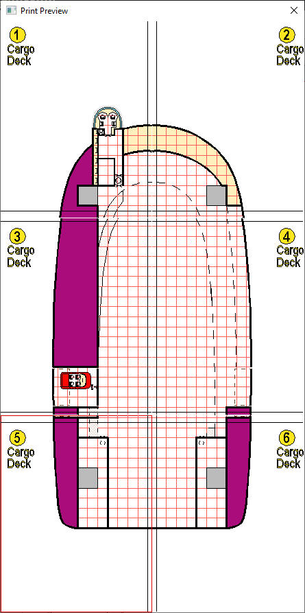

    Sample below; (note, this is the output from the above menu.)
    Questions?

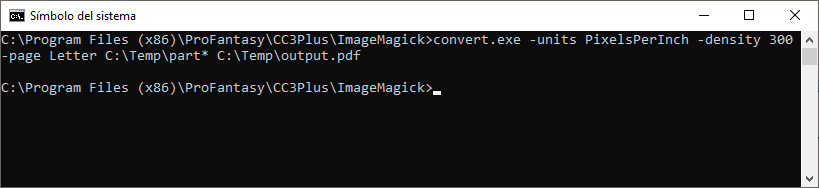

  • If you're comfortable with using the terminal/command line, and don't mind having all the pages in a single PDF... I'm honing towards a way to simplify step 3 (especially since CC3 already installs ImageMagick):
    convert.exe -units PixelsPerInch -density 300 -page Letter C:\Temp\part* C:\Temp\output.pdf
    However... it doesn't respect the page size. Maybe with a newer version of ImageMagick?
    Sorry if his is half-baked advice, but if I wait to have it fully tested, I might not ever send this. 😅

  • edited August 2025
    Yeah... I couldn't let it go. 😂
    Here's the fix:
    convert.exe -units PixelsPerInch -density 300 -page 2550x3300 C:\Temp\part* C:\Temp\output.pdf
    Basically, at 300 dpi, an 8.5 x 11 page results in 2550x3300 pixels. So instead of declaring "letter" I used those dimensions. Apparently letter is equal to "612x792".

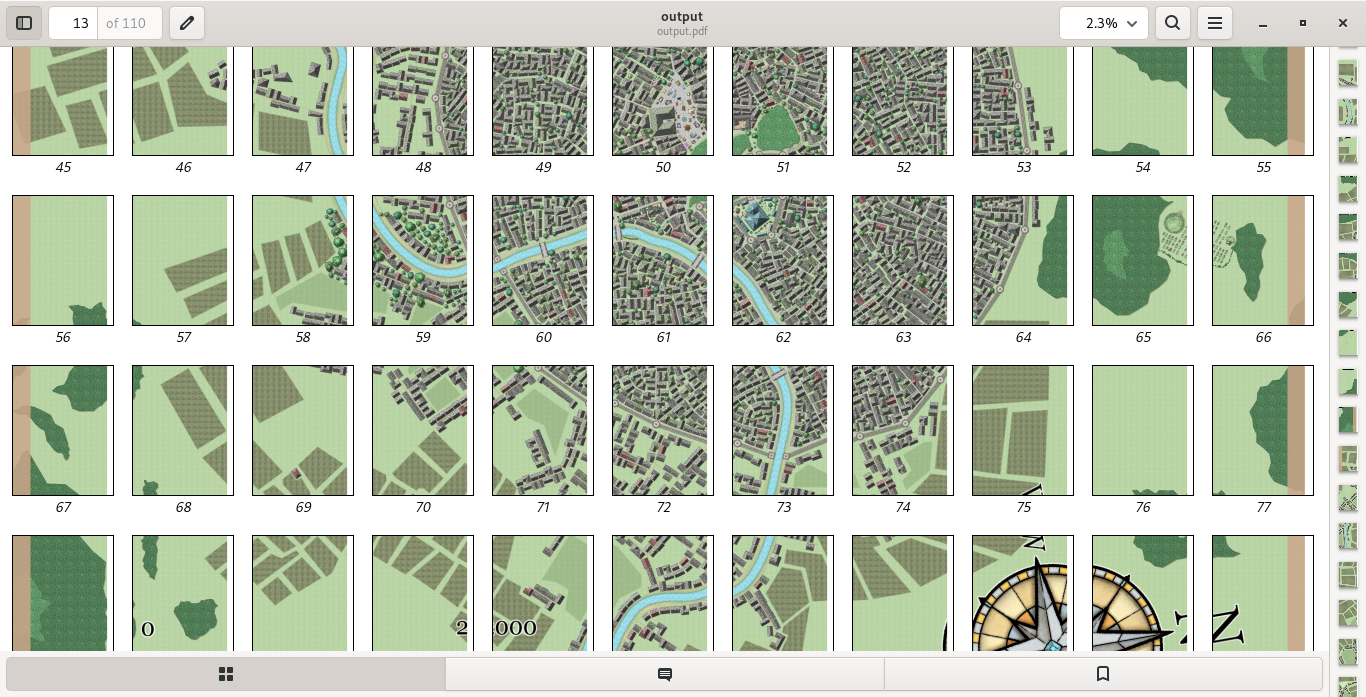

    The croppping/slicing also works. And you can do both things in one go, at least with a new version of ImageMagick:
    magick Greengulf_WIP.JPG -crop 800x1100 +repage -units PixelsPerInch -density 100 -page 850x1100 output.pdf
    (note that I switched too 100 dpi for this example -because I was being lazy-, so the page size was adjusted accordingly)
    And this is the result (I maximized the thumbnail panel and minimized the page display for this screenshot just because it looks better here in the forum).
    And all pages are 8.5x11 inches as needed.
