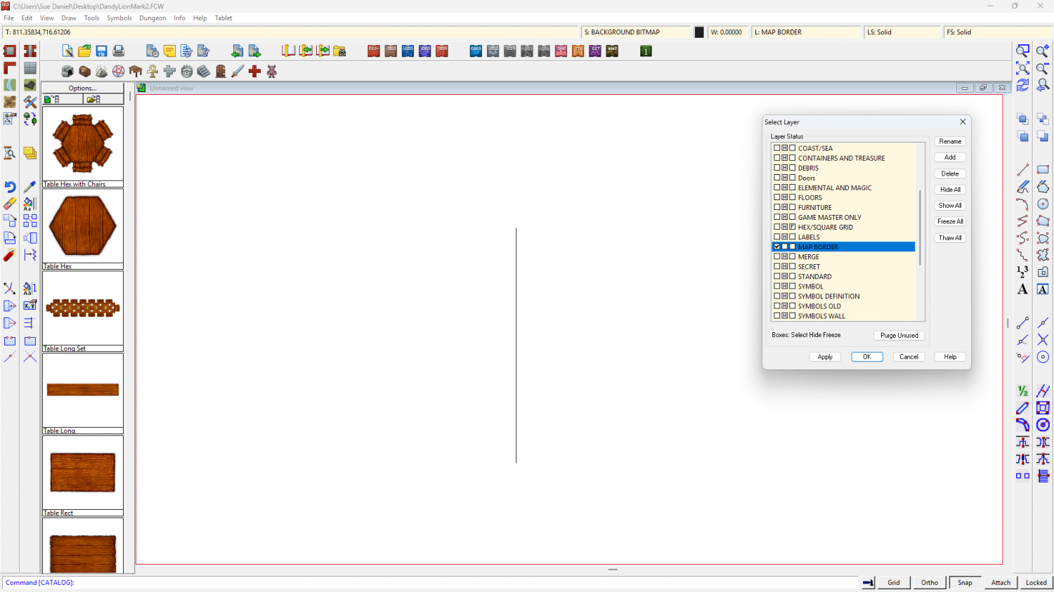

    The only entity on the MAP BORDER layer is a single vertical line on the right side of the Ground Floor map.

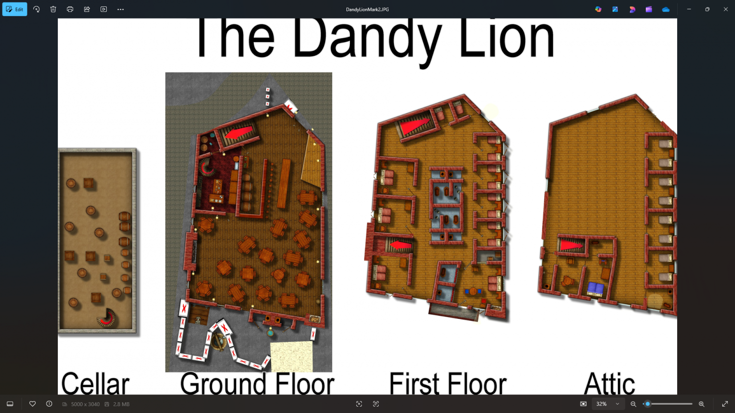

    I had the same export to image problem as you did until I deleted that line. Then I got this. Looks like I don't have the font you used, so it's defaulting to some kind of system font.
    These are the export settings I used, if you are interested.
    I recommend you delete that one line on the MAP BORDER layer and try one of the rectangular image export types, so you can define the area you want exported by clicking the corners of that area. If you show the snap grid and activate SNAP you will then be able to reliably export the same area again if you wish.
    Here is your second map with that line deleted.
