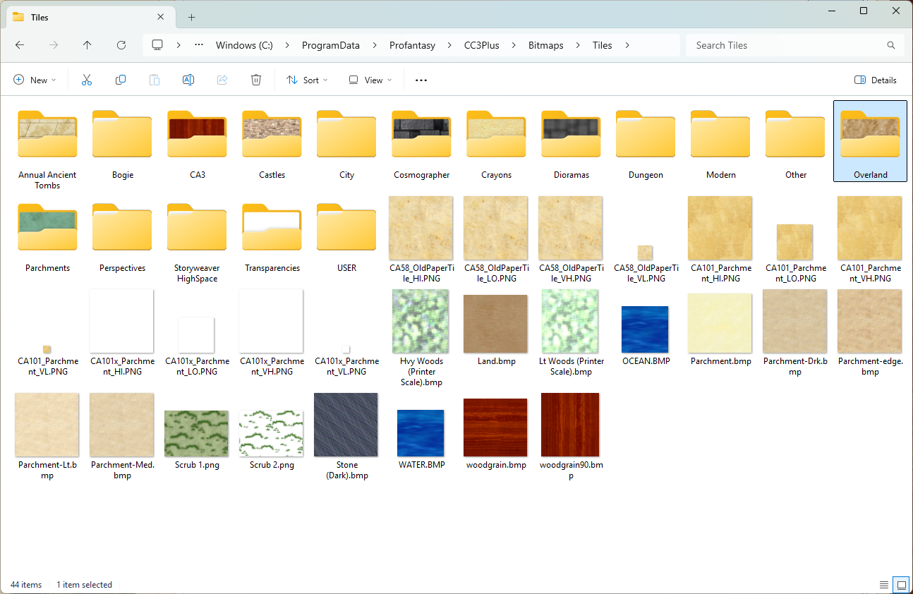

    Very generally they all go in the ProgramData\Profantasy\CC3Plus\Bitmaps\Tiles folder, but there is a well developed structure in that main folder, as you can see below.
    The annuals each go in one of these subfolders (above) according to what basic type they are - overland in the Overland folder, dungeon styles in the Dungeon folder, etc.

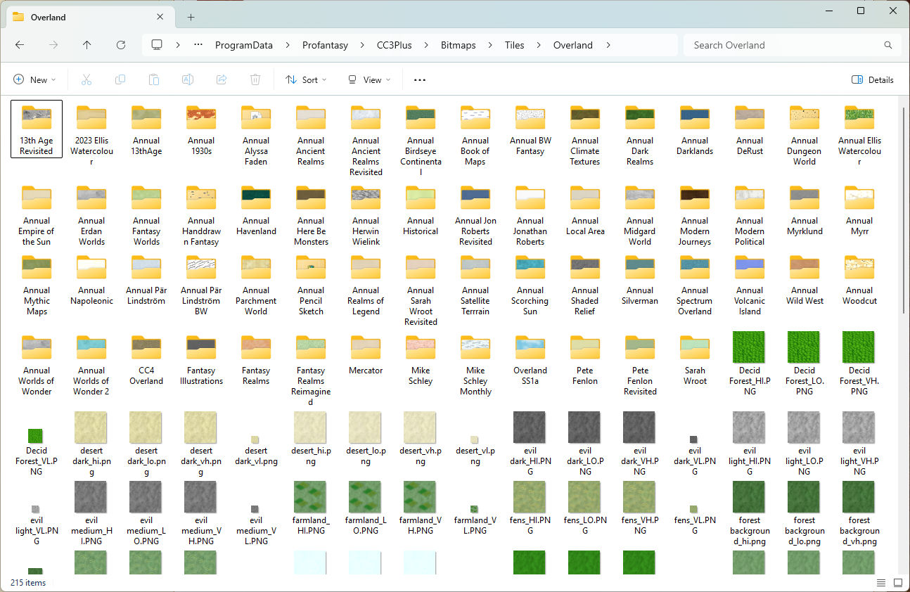

    These are all the annuals in the Bitmaps\Tiles\Overland folder - all the overland annuals are there in their named subfolders.
    Perhaps it's worth noting here (although it wasn't part of your question), that we encourage all user-generated fills to be put in a folder called USER placed in the Tiles folder, rather than scattered all over the place within the subfolders. It's a lot easier to copy your stuff and keep it safe if you get a new PC or have to do a major uninstall reinstall at any point.

    The USER folder is also a good place to store any 3rd party purchased fills - in their own subfolder.
