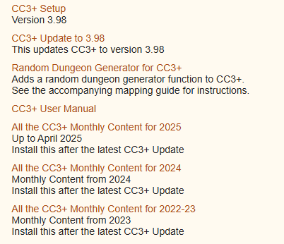

The free monthly content downloads are separate from the main CC3+ installers. You can find them in the CC3+ group here, where they are showing as the last 3 installers listed.

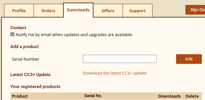

This is the downloads page when you log into your PF account. I can't show you the whole thing because that would reveal my own Serial numbers in public view, but the CC3+ download is top of the list for me.
You click the part where it says "(7 files)", and the dialog I showed you above pops up.
And light finally dawns! Many thanks, again. Obviously the bit on their page saying the free stuff is included in the CC3+ update needs to amend the webpage. I will do the install now, and hope all is well. My Tegel Manor map will once again be working properly - the party investigating it will be pleased.
