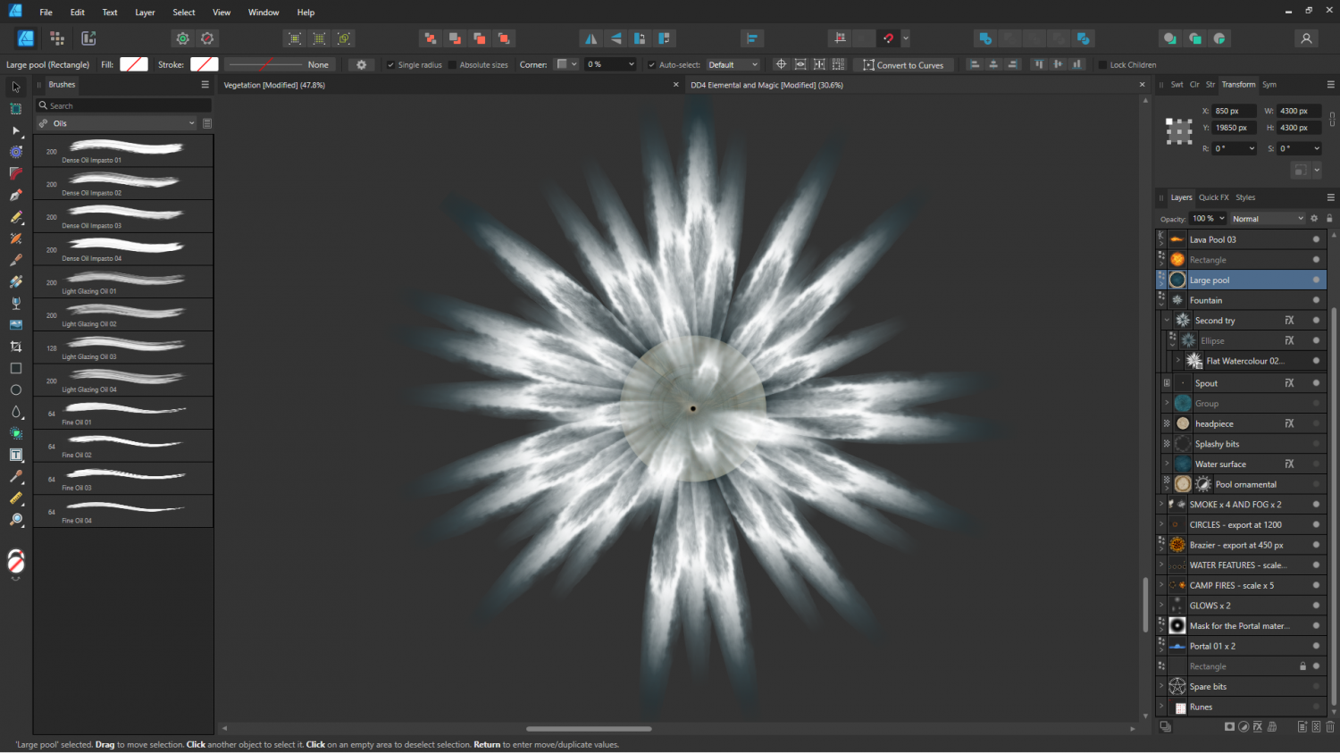

If you are lucky enough to own Affinity V1 or V2 (or if you rent PS or any other advanced image editor), the app has a selection of oil paint brushes that can be used as vector lines like this
A single stroke from the fountain.

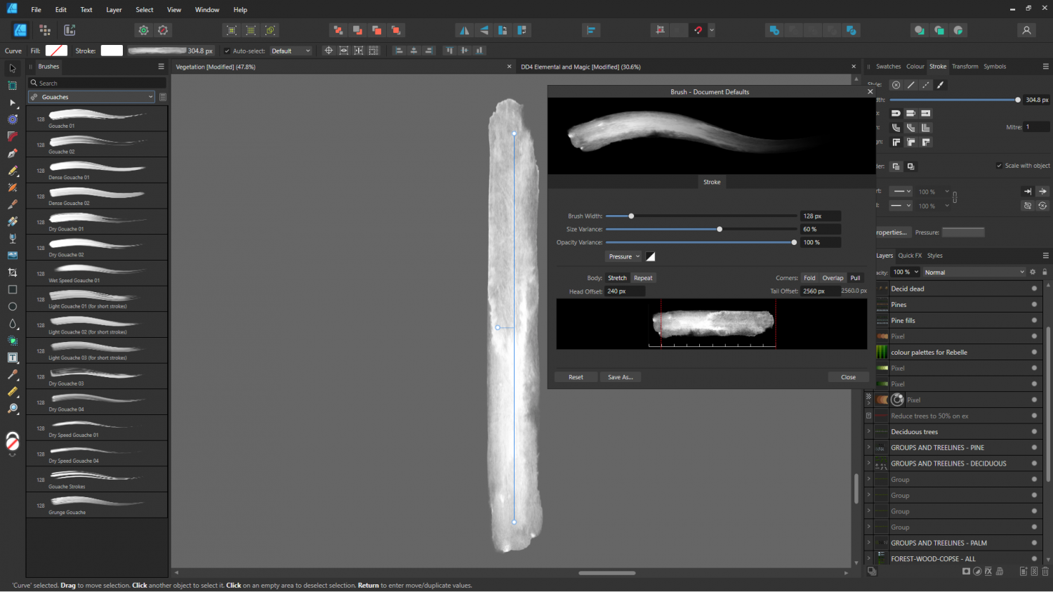

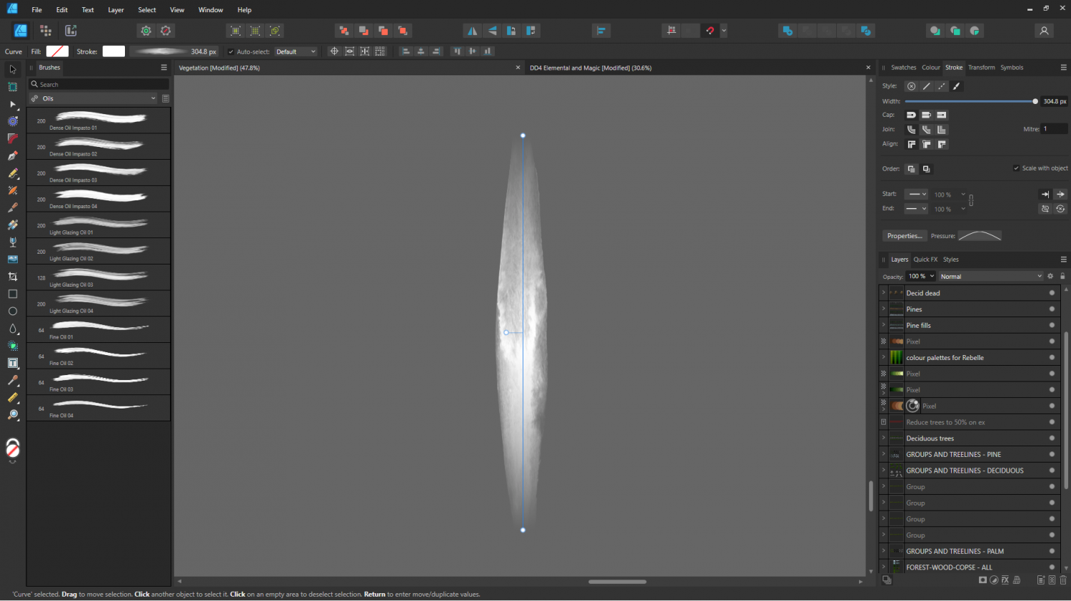

Or maybe it might have been one of the gouaches? It's really hard to remember after a year or so. This is the very same stroke with the end-pinching profile removed.

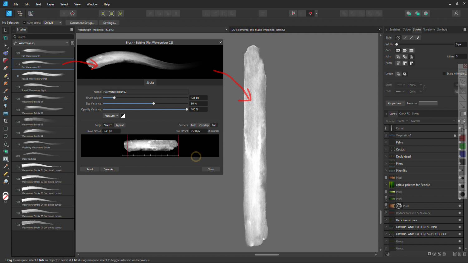

EDIT: I found the exact brush. It's called "Flat Watercolour 2". I think it's actually one of the Affinity V2 preset brushes, rather than something I bought.
