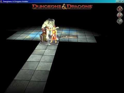

    If ProFantasy wanted to go all out, I would point then in the direction of Oblivion's character generator. Behind the scenes it's a 3D paper doll approach with on-demand texture map swapping (skin color, type, etc), morph targets on the face for individual personalization, and a expandable set of various species, gender, clothing and weapon types. There are freely licensed game-engines that will load the models (Pro fantasy will need to commission these of course) with customizable interfaces to add in the controls.
    The interactive online D&D 4e system (Virtual Game Table-now apparently vaporware) allowed players to do everyone above and save a screen shot of the complete model.
    Here is a demo: Watch between the time of 2:30 and 4:20.
